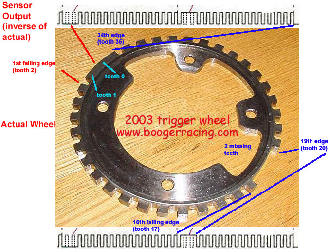

Secondly, here is a picture of it that I was linked this morning :
It looks to be fairly straight forward to write a decoder for, but I don't like these diagrams for credibility, so I'll need better information before I start. Preferably a photo of the disk(s) and/or a new time stamp log from a connected FreeEMS once I've written the logging code for that type.

Thanks! So are these hall effect devices or what?

Yes, it's hall effect. Crank pattern is same for 4, 6 and 8 cylinder engines with NGC. This includes 3rd gen Hemi. Camshaft pattern varies between engines.
2009 and newer V8's have different crankshaft ring with 58/60 teeth instead of 30/32 on older.

Small update on this:
Given that it's hall, and the layout of the pattern, it should be straight forward to do, logic wise.
The current missing tooth code, quite frankly, sucks, but once that's improved, this will be easy to do with some code reuse.
Keep an eye out for missing tooth performance improvements and bug me when you see them.

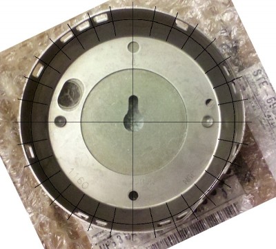

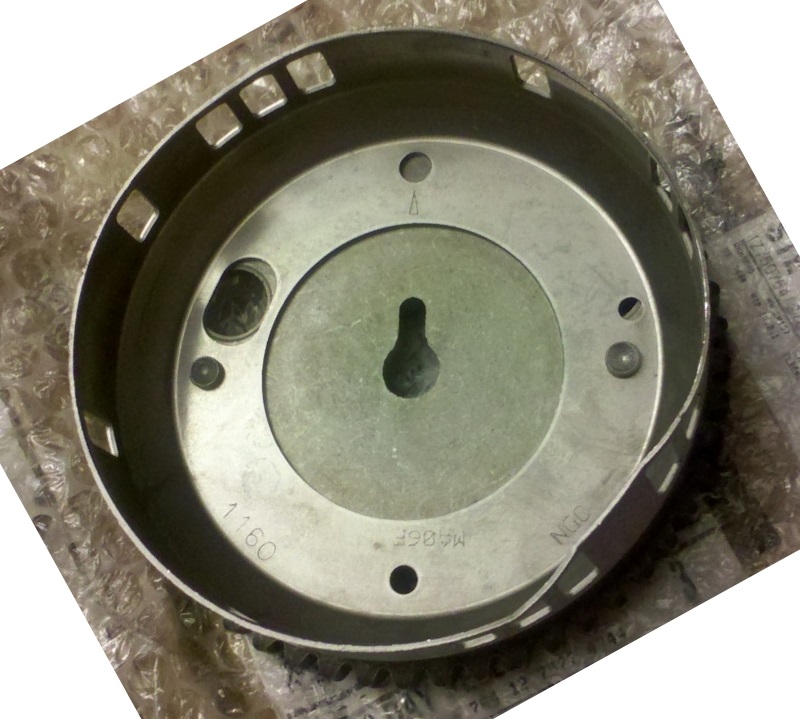

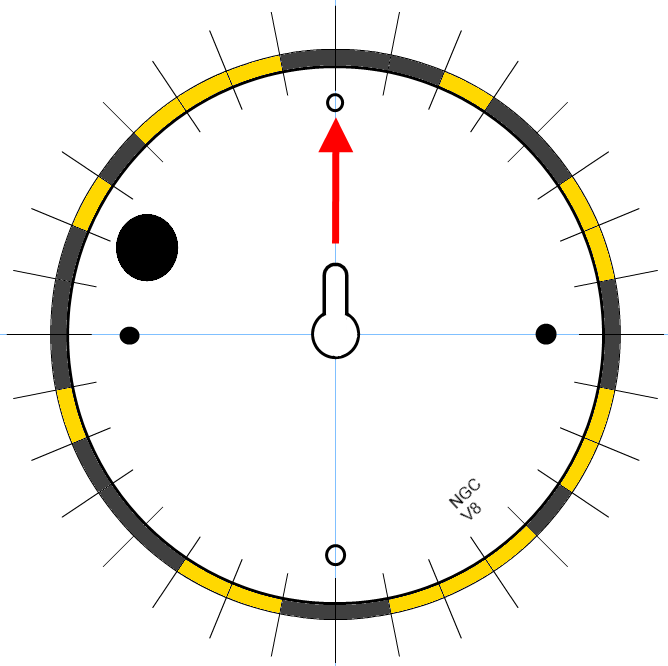

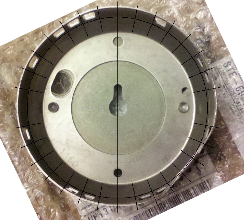

Two photos of NGC V8 pre-2009 camshaft tonewheel (aka reluctor ring or whatever you want to call it) after shipping via UPS. Author unknown, found via Google image search. Third picture (and overlay on first) by me but should be accurate. Yellow sectors mark location of holes. Camshaft keyway and red arrow point straight up when #1 piston is TDC. Crankshaft key is pointing then to 2 and afaik missing teeths of crank wheel are also at 2 o'clock then.
I think we're still missing exact info about how crankshaft and camshaft wheels are aligned against each other. Likewise info on which hole/teeth marks #1 TDC still needs to be confirmned.
I have engine to play with but without factory ecu to drive it will be limited to probing signals from sensors with Open logic sniffer and Saleae while turning it with starter or by hand. Plus it's 500km away meaning can't just walk in to garage and start working.

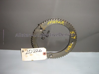

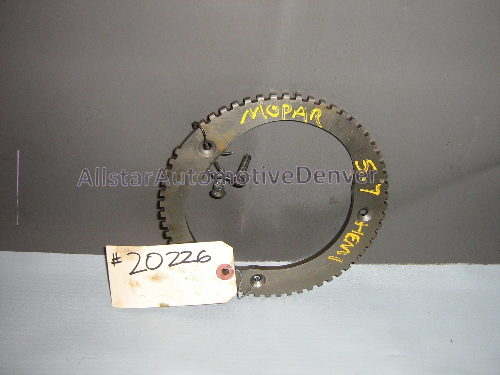

Chrysler changed to 58/60 tooth ring in 2009. Only pic of it I could find attached.
Re: Chrysler 420a, Jeep, Viper Pattern
Just a standard 60-2 wheel, by the looks? Still Hall, or VR from then on? Same cam sync stuff or different?
